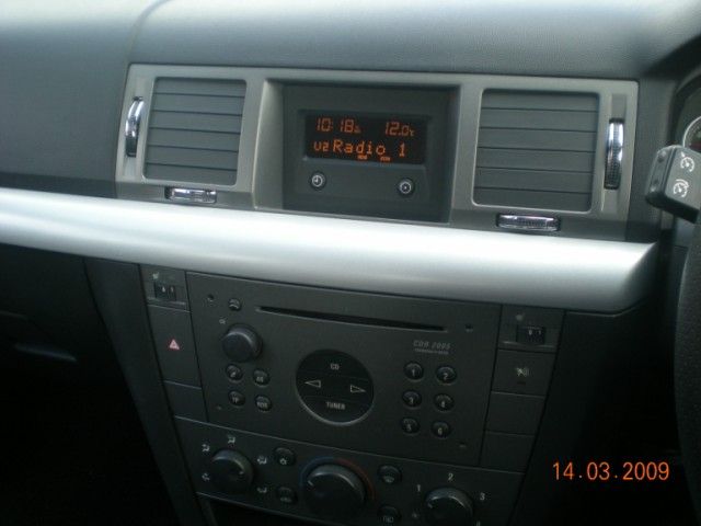

Benim aracimda bulunan bilgi ekrani yarim olanlardan yani yalniz tarih, saat ve derece yi gorebiliyorum.
acaba ben baska bir vectradan tam olan ekrani ve silecek kolunu alip aracima montajini yapsam verim alabilirmiyim ??

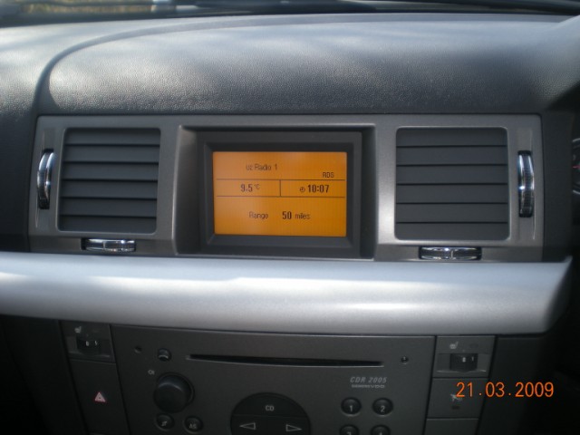

o zaman birde sana şunları ekliyim..
Well finally got a GID,wiper stalk fitted and connected the GID to the diagnostic plug and i have to thank Don (bigmac) for the screen and pins for the diag plug......
It still needs a trip to a dealer for a tech2 session,but would like to thank everyone who helped me get to the finished article,here's the pic's for your veiwing pleasure............
As it was..........
And how it is now........
Comments good or bad...........
